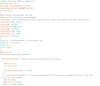

Step 5: CODING
You can download the code for this project via the file below or preview/copy the code here: https://create.arduino.cc/editor/popul4r/66708ccb...
The code of this project consists of three main things:
1. The function of the two buttons
2. The function of the LEDs
3. The function of the speaker
One button (Button 1) in the project will function as a start button to the stopwatch (before anything is pressed, the LCD screen will instead show the message "press the button" to instruct the user). When the first button is pressed, the stopwatch will start counting up in seconds. The first button is connected to pin 8 of the Arduino board
The second button (Button 2) will act as a stop and restart function for the stopwatch. When the second button is pressed, the stopwatch will first stop, then if pressed again will restart the stopwatch. The second button is connected to pin 9 of the Arduino board
One led will be green and one will be red (or any other color). One led will be on when the stopwatch is counting, while another will be on when the stopwatch stops counting. In this project, the green led turns on when the count starts, while the red one is not. When the stopwatch stops, the red led turns on instead of the green one. The pin for the green LED is pin 4 and the red LED is pin 7.
The speaker will make a frequency wave or a buzzing sound when the stopwatch restarts. So if button 2 is pressed two times, the speaker will automatically turn on and make a sound to warn the user that the stopwatch has restarted. The sound will continue until button 1 is pressed to start the stopwatch again.

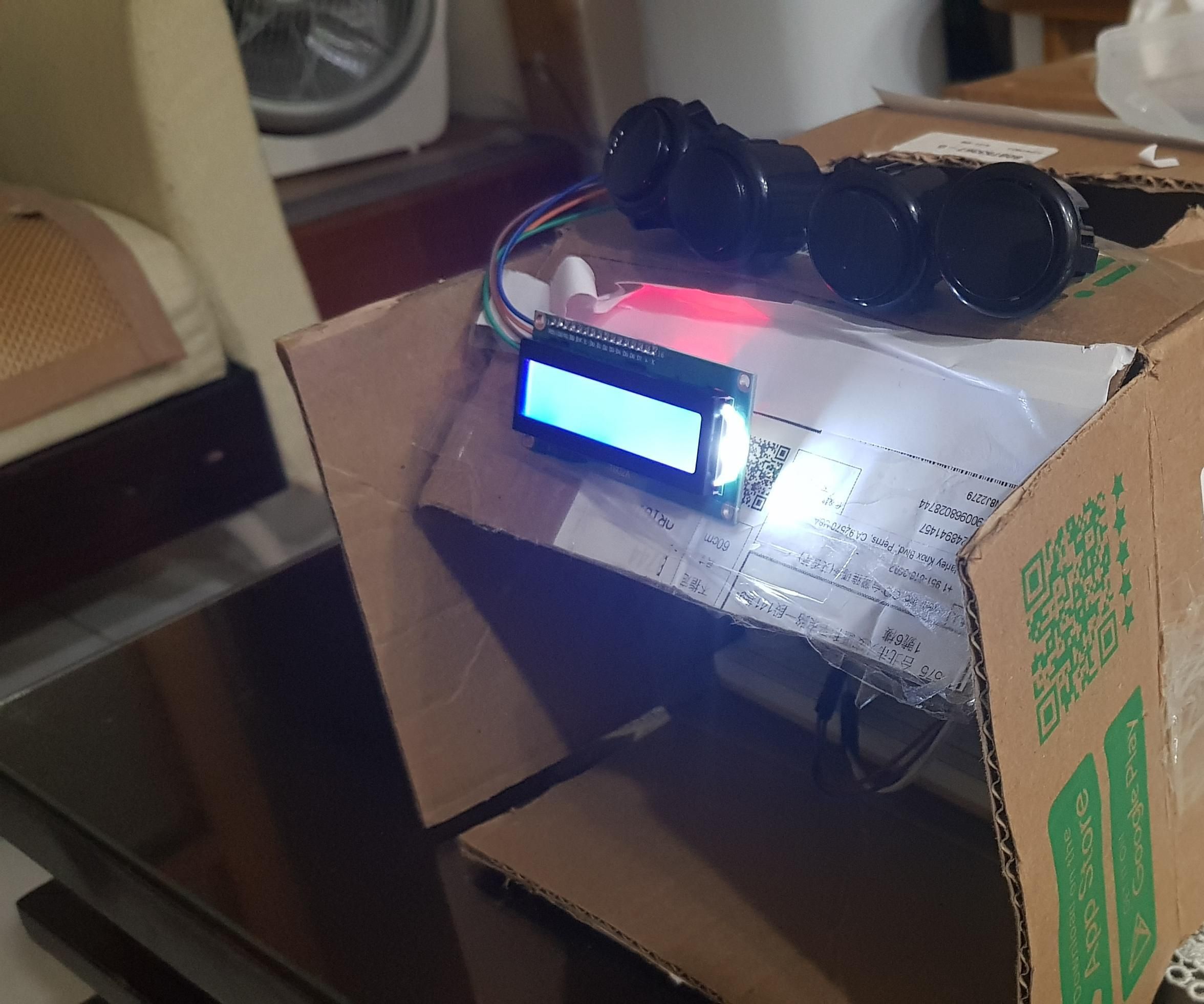

Step 6: YOU'RE DONE
The project is finished, upload the code to the computer then plug-in power to the Arduino Leonardo for the project to start operating (the cardboard box shown in the photos is optional).
