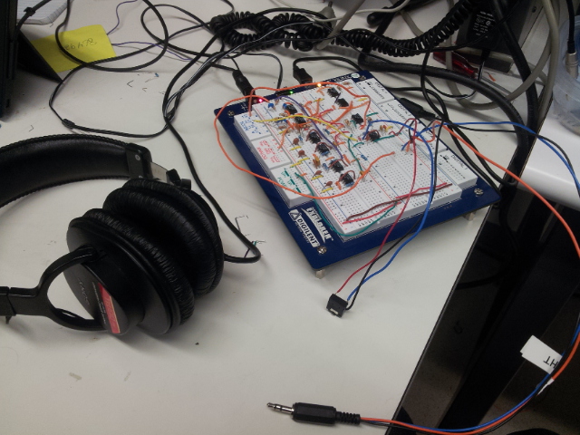

Step 2: PPG Circuit
A photoplethysmogram (PPG) is a measurement of blood volume by light. By measuring how much light passes through, for example, a finger, you can get a relative measurement of how much blood was in the finger. The more blood there is, the less light gets through. By tracking blood volume over time, you can calculate the heart rate of the user.
The circuit for the PPG consists of three main blocks. Those are the LED driver circuit, the photosensor circuit, and the signal conditioning circuit.

LED Driver Circuit:
Components:
1. LTC1043CN Switched Capacitor Building Block
2. 2N3904 BJT
This circuit is responsible for driving the LED, pulsing it at 2 kHz and 50% duty cycle. The switched capacitor building block takes care of generating the pulsing signal, which is used to drive the BJT which pulls down a current through the LED. The resistors are current-limiters and crucial to operation. Without them the BJT or the LED will blow. The frequency of the signal is set by an external capacitor. We found that 2.2 nF works well, but you might have to tweak that number to get it just right. It's important to get this signal close to 2 kHz as we will use this clock later to set the cutoff for a filter
Photosensor Circuit:
Components:
1. LT1056 op-amp
When struck with light, the photosensor acts as a current source. The op-amp is configured as a bandwidth-limited transimpedance amplifier, providing a voltage to the signal conditioning circuit. When there are different amounts of blood volume in the finger the photosensor will detect different amounts of light, thus providing a changing signal in sync with blood pulses.
Signal Conditioning Circuit:
Components:
1. LTC1043 Switched Capacitor Building Block
2. LT1167CN8 Instrumentation Amplifier
3. LT1112 Dual Op-Amp
4. LTC1064 8th order Butterworth Low-Pass Filter
The first stage of the signal conditioning circuit is the sample-and-hold instrumentation amplifier. During each clock cycle, the switched capacitor building block will switch its output to each of the instrumentation amp inputs. Those inputs have small capacitors for the purpose of holding their value until they get updated the next clock cycle. During the ON part of the clock cycle, the LTC1043CN will push the photosensor signal to one output, and during the OFF part of the clock cycle it will push the value to the other input. This provides a base value of the ambient light for the instrumentation amp to compare the LED light value to, improving the SNR. It is important to have the power rails of the instrumentation amp properly decoupled. A lot of 2 kHz noise can come into it from the LTC1043 clock generator, which would be amplified by this stage if not properly decoupled.
The next stage of the signal conditioning circuit is a high-pass filter with a cutoff of .1Hz on one of the op-amps of the LT1112. This acts as a DC-blocker, making the signal easier to work with in the rest of the signal path.
The stage after that is an 8th order Butterworth low-pass filter with a cutoff frequency of 20Hz. This stage with remove the 2 kHz oscillation in the signal that came from the LED modulation. Pin 10 of the LTC1064 is set to the negative rail, which sets the cut-off frequency of the filter to 1/100 of its clock frequency. This is why it was important to properly set the clock frequency earlier, so the filter would have the proper cut-off.
The final stage is a simple low-pass Sallen-Key filter on the second op-amp of the LT1112. With a cut-off frequency of 100 Hz, it gets rid of the small amount of clock noise that comes from the LTC1064 itself. At the output of this filter you will have a very clean and clear signal from which you can measure the heart rate!
The initial testing of this circuit was done with +- 7.5V rails (the maximum the LTC1043 can handle), but for operation with the Arduino analog pin we had to switch it to 5V rails. The circuit still operates well at this power.
