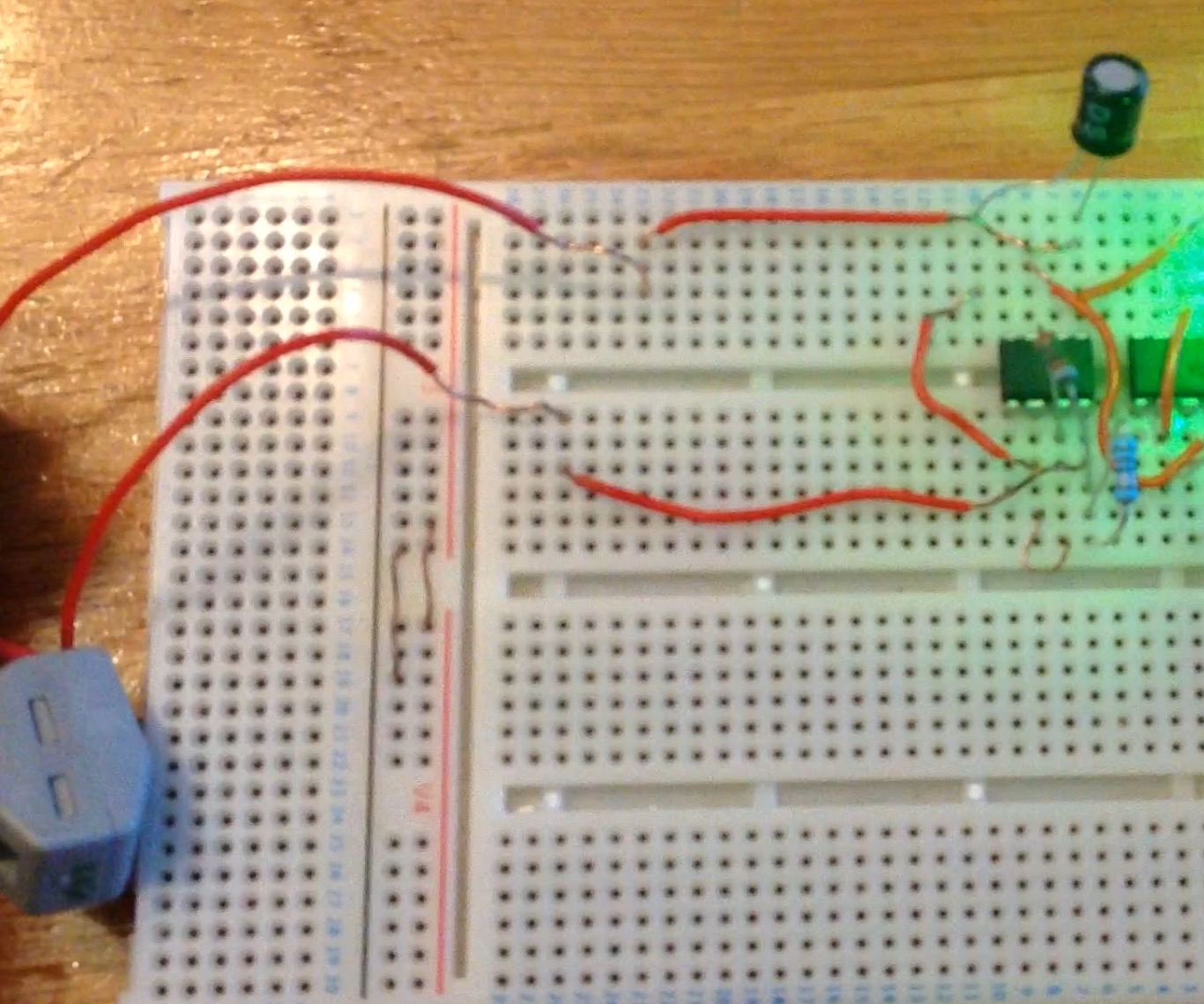

Step 1: Wiring
The most basic task was the wiring of the OLED to the Arduino. We connected the GND and VCC to the respective busses on the bread board; SCL to digital pin 13; SDA to digital pin 11; RES to digital pin 8; DC to digital pin 9; CS to digital pin 10 and finally BL to 3.3V on the Arduino. Using the 5v and GND pins from the Arduino we were able to power the entire bread board.
