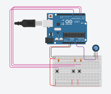

Step 1: Make the Circuit
I started to build the circuit on a breadboard and test everything out. For this step, you just have to follow the schematics or follow the following instructions.
  • Plug the potentiometer
  1. Left pin connected to GND
  2. Right pin connected to 5V
  3. Center pin connected to A0
  • Plug the button
  1. One pin is connected to 5V
  2. The second pin as to be connected to a digital input
  3. There is only 2 interrupt pin on Arduino Uno so I have to connect the third button on DigitalPin7.

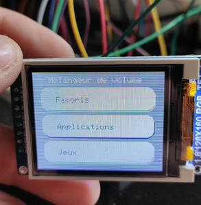

  • Plug the screen
  1. GND connected to GND
  2. VDD connected to 5V
  3. SCL connected to Digital 13
  4. SDA connected to Digital 11
  5. RST connected to Digital 9
  6. DC connected to Digital 8
  7. CS connected to Digital 10
  8. BLK connected to 3.3V
/!\ You have to add pull up/down resistor on all buttons to use it correctly /!\
To do it just plug a high value resistor connected to the DigitalPin and to ground at the same time and its done.

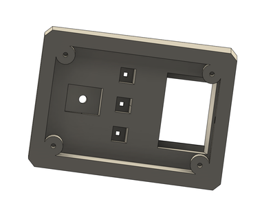

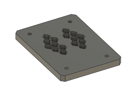

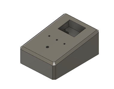

Step 3: 3D Modeling
Well this was my first experiences with 3d modeling but I thing the result is quite good. I used fusion 360 because the software was totally free for students.
In this part you have a lot of thing to do, unless you need to make your own design.
If you want to do it by yourself, don't forgot to add some air outlet to fresh up all the components.

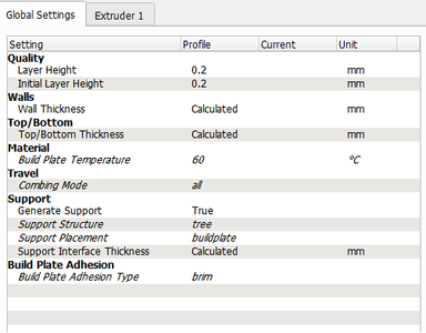

it took me 15 hours to print the upper part and 6 hours to print the lower part .
I printed it at 210° degree and the bed was at 60° . Due to my bad bed leveling skills I had a little bit of warping and some problem with support . If you want to avoid this problem just level your bed carefully and use tree support.

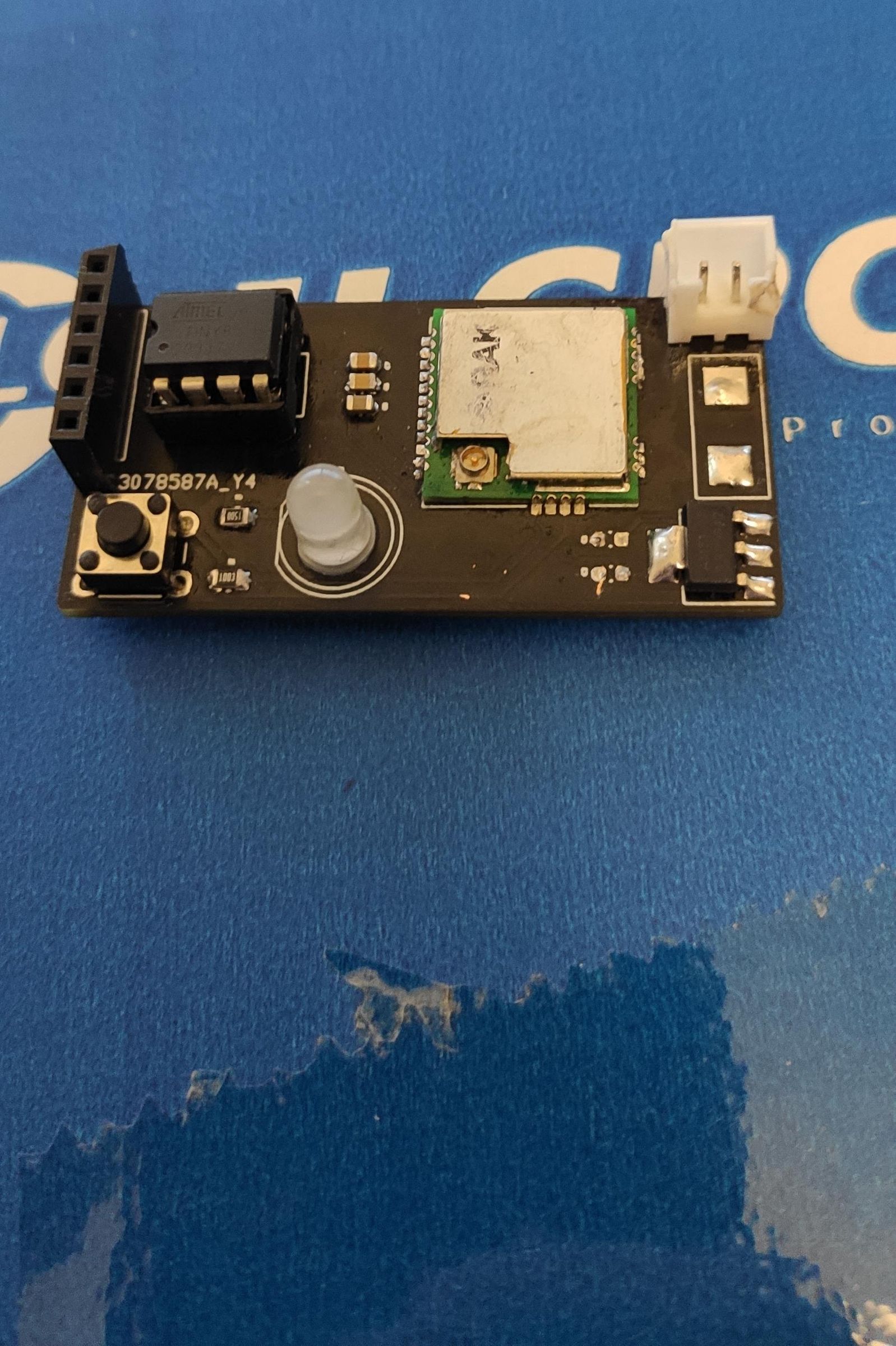

First thing I want to do is make a PCB to look more professional. To do that I used easyEda and I bought it on JLCPCB. As I don't want to solder all the tiny component I use jclcpb assembly services. It cost me around 15 $ but if you want to do it by yourself it will cost you around 6$
