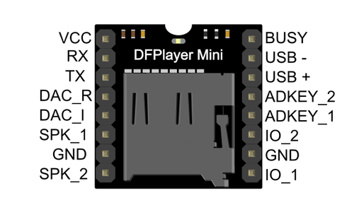

  • The connection diagram is relatively easy. Attention when uploading the code to the Arduino, this is done with the RX pin of the Arduino disconnected from the HC-05 module, or without the module being connected, this is done after uploading.
  • If you get confused in the serial pins of the MP3 mode or if the Arduino does not respond vocally, reverse the connections to its RX-TX pins.
