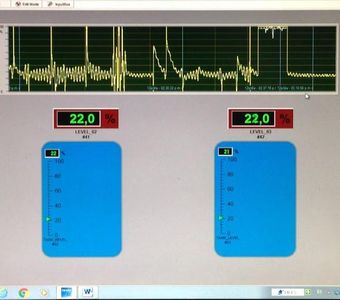

This project consists in monitoring the level of water in two tanks.
Information about the level of the liquid in the tank will be shown in a screen, where you will be able to see the numeric values and the graphic values. There are many ways to sense level. You could use pressure sensors, ultrasonic or discrete (switches) sensors. I use potentiometers attached to a floating mechanism to bring “analog data” information to the Arduino board For the HMI I found an application for Arduino in the web, develop by Ulrich Albert Maassen.
The web address to download this application is: www.SerialComInstruments.com
In the figure I show the screen for my project. Blue boxes represent the tanks, in the upper side are the numeric values expressed in % (0%-100%). At the top of the screen you can see the trending of both levels of the tanks.

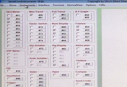

Selecting the field “Instruments” you can select a diversity of resources for your project

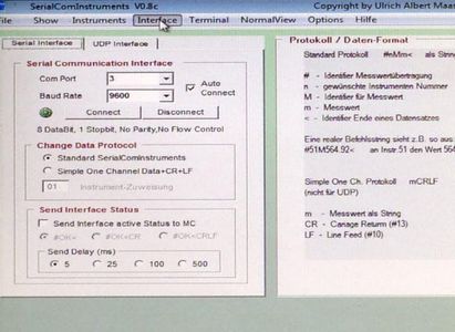

Then you can select the Serial “Interface”, where you specify: Com Port, Baud Rate, also you can change the Data Protocol

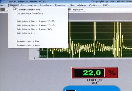

If you select “Show”, you will be able to Connect and Disconnect the interface, and you can go to the Edit Mode. In this mode you can build your display
