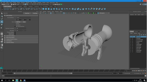

To lastly make a simple Pistol, we can either 3D print our personal design or buy a cheap one.
NB: The Pistol design might be different for each project, but the way the laser circuit works stay the same.
