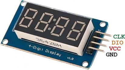

  • Connect LED Display pin[CLK] to Arduino digital pin[6]
  • Connect LED Display pin[DI0] to Arduino digital pin[7]
  • Connect LED Display pin[GND] to Arduino pin[GND]
  • Connect LED Display pin[VCC] to Arduino pin[5V]

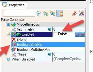

  • Select "PulseGenerator1" and in the properties window set "Enabled" to false, and click on the Pin Icon and select "Boolean SinkPin"
  • Select "PulseGenerator1" and in the properties window set "When Disabled" > "Reset" to true

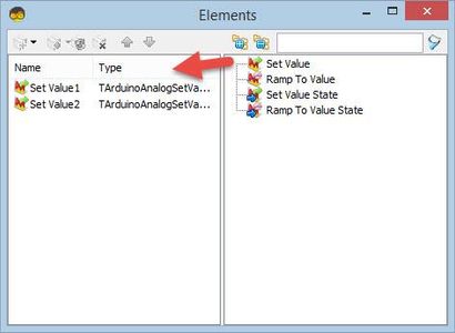

  • Double click on the "AnalogValue1" and in the "Elements" window drag 2x "Set Value" to the left side
  • Select "Set Value2" and in the properties window set "Value" to 0.5
  • Close the "Elements" window

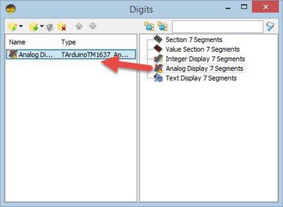

  • Double click on the "Display1" and in the "Digits" window drag "Analog Display 7 Segments" to the left side
  • Close the "Digits" window
