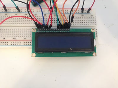

Step 2: LCD Display
Okay, so you can now mount the LCD Display wherever you would like, on the breadboard. (Just not on the power rails, obviously.)
Note: for the LCD display you will need 12 jumper wires.
Before you do the next step, attach a jumper wire from the Arduino 5V pin, to the breadboard positive power rail. Next attach a jumper wire from the Arduino GND pin, to the breadboard negative power rail. You are now ready to go to the next step.
Step 3: Wiring for the LCD Display
Alright, now for the more "complicated" part: Note the change from "LCD 6" to "LCD 11"
The potentiometer can go wherever you would like on the board.
______________________________________________________________________________________________
LCD 1 to breadboard negative power rail
LCD 2 to breadboard positive power rail
LCD 3 to potentiometer centre pin // this helps to change the LCD brightness
LCD 4 to Arduino Digital Pin 12 // Arduino sends LCD data (LCD character coordinates)
LCD 5 to breadboard negative power rail
LCD 6 to Arduino Digital Pin 11 // Arduino sends LCD data (LCD initiate command)
LCD 11 to Arduino Digital Pin 5 // Arduino sends LCD data
LCD 12 to Arduino Digital Pin 4 // Arduino sends LCD data
LCD 13 to Arduino Digital Pin 3 // Arduino sends LCD data
LCD 14 to Arduino Digital Pin 2 // Arduino sends LCD data
LCD 15 to 220 ohm resistor and then the same 220 ohm resistor to breadboard positive power rail
LCD 16 to breadboard negative power rail
Potentiometer positive pin to breadboard positive power rail
Potentiometer negative pin to breadboard negative power rail
Once you've finished all of that, you can go to Wiring the TMP36 Temperature Sensor.

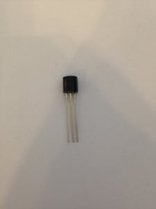

Okay, so we've gathered all of our parts, and we've wired the LCD Display to the breadboard and Arduino. Now we need to add the TMP36 Temperature Sensor. Follow the steps below:
1 - Put the TMP36 onto the breadboard wherever you would like, be sure the flat side is facing away from you. (Again, not on the power rails)
2 - Attach a jumper wire to the middle pin of the TMP36. Attach the same wire to the Arduino "A0" pin.
3 - Attach the positive (right pin) to the positive power rail.
4 - Attach the negative (left pin) to the negative power rail.
After you have completed wiring the TMP36, you can go to the next step!
