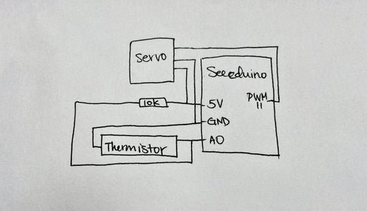

Materials:
Seeeduino (or Arduino) X1
Servo X1
10k resistor X1
50k Thermistor X1
Jumper wires
All materials except the board come from Seeedstudio's Sidekick Kit, which can be found here:
http://www.seeedstudio.com/depot/Sidekick-Basic-Ki...
The picture illustrates the schematic
