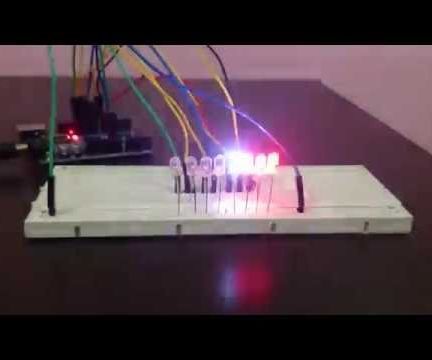

1. Place five LEDs as such in the image above with all cathodes connected to the negative rail.
2. Connect the negative rail to the Gnd and the positive rail to 5v.
3. Now place the thermistor in the board away from the LEDs.
4.Connect one lead of the thermistor to the positive rail.
5. Connect the other lead to the negative rail via 10k resistor. Connect the same lead to A0.
6. Wire up the LEDs as shown in the image.
