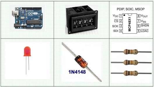

Parts and components
  • Arduino Uno board
  • Thumbwheel switch = 4 Nos
  • IN4148 Diode = 16 Nos
  • 10K Resistor = 4 Nos
  • MCP4821 DAC = 1
  • 330R resistor = 1 No
  • RED LED = 1 No
