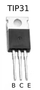

-2N3906 transistor
-TIP31 transistor

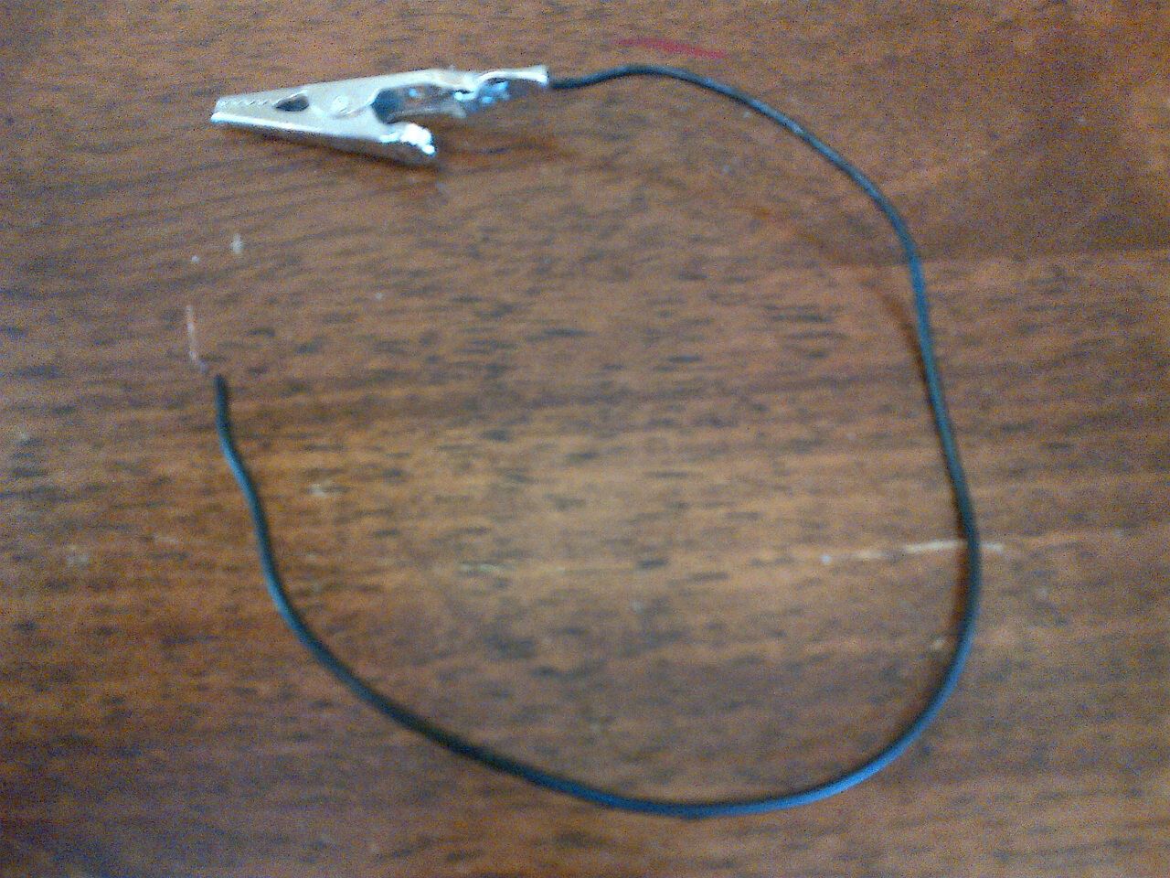

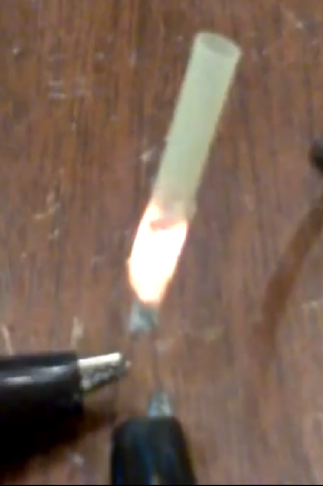

-A low voltage electrical igniter(optional)

Also, this design is only capable of lighting a very low power electrical igniter or light. If you want anything that uses more power, you will have to use an external power supply.

-2N3906 transistor
-TIP31 transistor

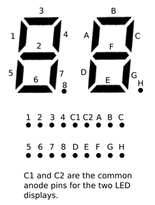

Step 2: Testing
If you have ordered the LED display that I did, it should have the same pinout. C1 is the common anode pin for the left digit, and C2 is the common anode pin for the right digit. When positive is connected to pin C1 and negative to pin 1, LED 1 on the LED display would light up. You should make sure that each pin lights the correct LED before proceeding. When testing the device, remember that this display is designed to use 2.2 volts. I used a two AA batteries and a 68 ohm resistor for testing.
