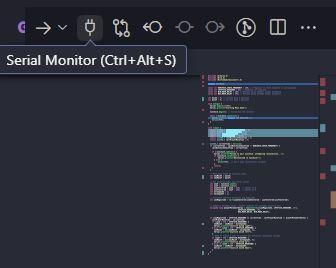

Using https://www.unixtimestamp.com/, set the RTC's timestamp using the Serial Monitor. You can open the Serial Monitor by clicking the 🔌 looking icon in the top right of the VS Code Editor.
