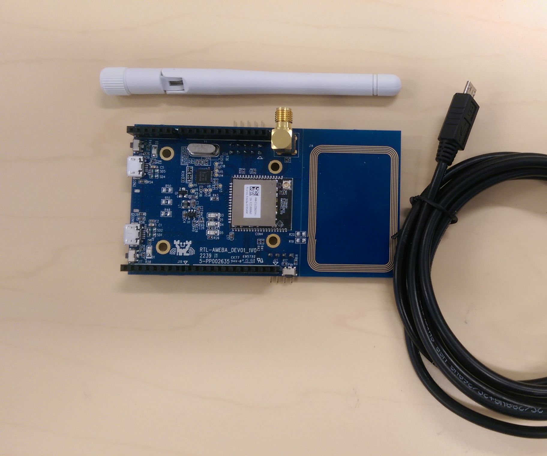

- Ameba Arduino board - The main reason to use this Arduino compatible board for this project because of its built-in wireless so we don't need an extra wifi shield. You can search for "Ameba Arduino" in eBay about it. it cost about $25.00

Step 2: Connections
There is no extra wiring except simple USB connections.
There are 3 micro USB host on Ameba, the one at the back supports OTG UVC, by which the USB camera can transmit video data to Ameba, and Ameba sends it to the network through wifi. Connect Micro USB OTG to Ameba, then connect the Webcam type A connector to the adapter.
