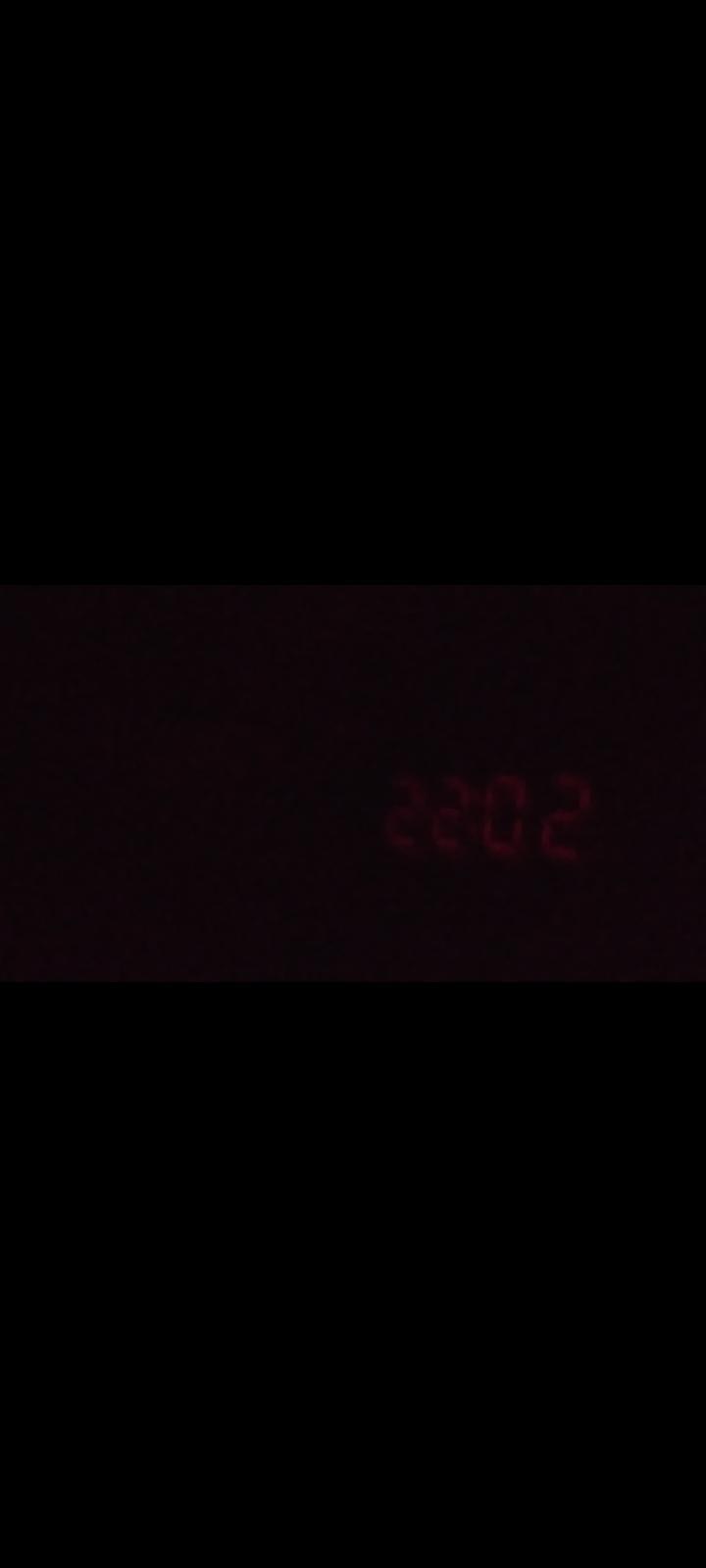

I hate when I wake up in the middle of the night and I don't know what time it is. In order to see what time it is, I have to get out of bed, which I really don't like. That's why I thought a little and came up with the idea of making a projector that will display the time on the ceiling.

Step 4: Fitting Into Box
First take the mirror and place it into box, than use glue to hold it in place. Put Arduino in box and glue it. Take the display and rotate it so the display is watching the mirror, make the angle of 10* like shown. Make the hole for the cable.
Step 5: Closing the Box
Make a hole on the cover of the box. Turn on the Arduino and you will se the the time on the mirror. Take a magnifying glass and use it to find the perfect angle. When you find the perfect angle you will see the time on the celling. Take a glue and stick the magnifying glass in place. If you se the clear "image" of the time, that is good, if not you need to rotate the magnifying glass. That is all. This is how you can make a time projector. Hope you will find this useful. Good luck with making.
