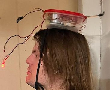

To fix a long standing problem of running into things behind and in front of me, I created this Arduino-Powered helmet that uses Time of Flight sensors and LEDs to prevent me from ever being hit again*.
*note: Does not work if objects are above you, below you, to the sides of you, anywhere else outside of the narrow fields the sensors cover, and if the objects or you are moving at more than a moderate speed.
The "helmet" uses a single Arduino R3 to power two VL53L0X Time of Flight sensors and two red LEDs which when an object gets within a set distance will light up in your periphery to alert of impending danger. The Instructable walks through the process I went through to create the working prototype of my idea, as well as challenges I faced and ways you could possibly expand the project.

Warning: In my project due to time and budget restraints I used a plastic Tupperware container as the housing for my circuit. I used a hobby knife to cut holes into the container for the sensors and LEDs to pop out of. This ended up being by far the most dangerous part of the project, as the top half did not cut easy, and the bottom half cut too easily, pieces constantly snapping off violently. I would caution against using the container I did and if you do, urge you to work slowly and wear protective eye wear.
The design of the enclosure is simple, get a container big enough to fit the Arduino and whatever size breadboard you end up using, make openings for the the sensors and LEDs to poke out and create a way for it to attach to your head somehow. I made two small openings in the bottom of the container and threaded a lanyard through, tying it underneath my chin to secure the headpiece.
I originally was planning to create a 3D printed case and attach to a protective screened mask but due to an unexpected time crunch I ended up going with the "no extra cost" prototype design I did and it taught me a bit about the importance of prototyping as I encountered several design mistakes through this process that can be seen in the model shown in the photos. One is that the sensors can capture only a limited, fairly narrow field, and if the sensors are misaligned in any way it makes this much more apparent. This is something I likely would not have caught onto until I finished my original design if I had not made this prototype which accentuates this design flaw more than normal.
