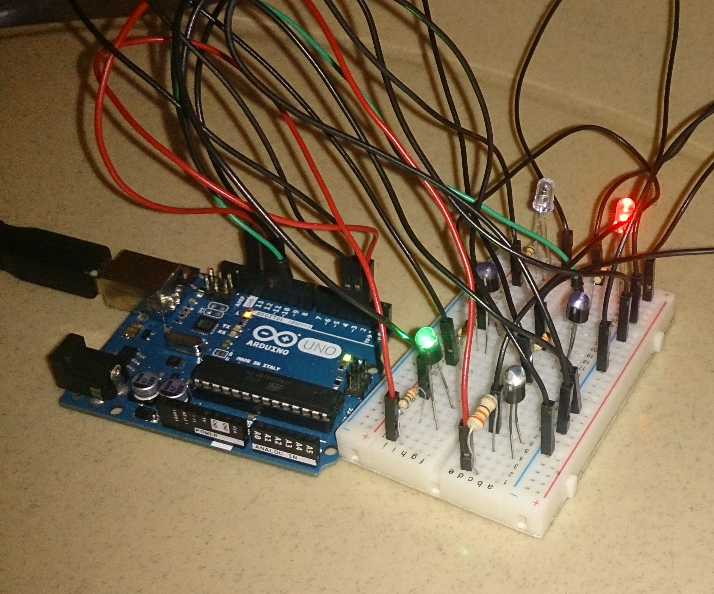

Step 2: Circuit
There is nothing much new in the circuitary. Everything that you need to work on to build a timer is in the code. People who might have already worked on using LCD, can finish up the connections pretty easily. LCD Connections to the arduino board are the same and additionally use the switch and push buttons to connect to the digital pins.
Anyways for beginners, i had attached the circuitary for reference. Feel free to contact if there are any queries.
