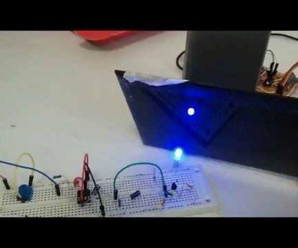

Step 9: Final Pictures (without Casing)
This is how it looks like without the casing and mechanical apparatus, front and back.
