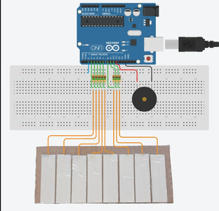

Step 3: Assemble the Circuit
Assemble the circuit as shown in the image above.
You can change the sensitivity of the sensors by changing the resistor value:
  1. You can use a 1 megohm resistor for absolute touch to activate.
  2. With a 10 megohm resistor the sensor will start to respond 4-6 inches away.
  3. With a 40 megohm resistor the sensor will start to respond 12-24 inches away (dependent on the foil size).
More info about Capacitive Sensors here.
Note: The schematic doesnt include the connections from the resistors to the piano keys

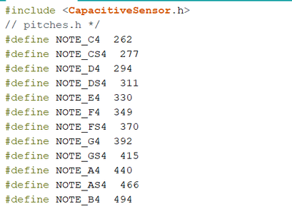

Step 4: Code: Define Notes
We first include the CapacitiveSensor library. It lets us measure capacitance on a pin.
Next we define musical notes as frequencies in hertz (Hz).
  1. Each NOTE_ corresponds to a particular pitch — for example, NOTE_C4 is Middle C (about 262 Hz).

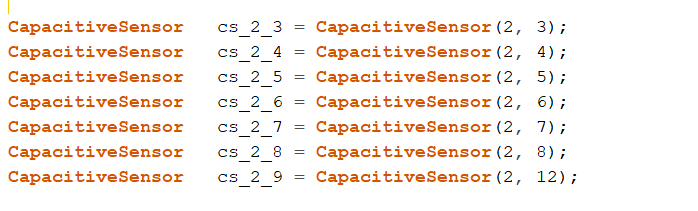

Step 5: Code: Initializing Sensors
We create CapacitiveSensor objects for each touch sensor.
  1. The first number (2) is a “common” or “send” pin;
  2. The second (like 3, 4, 5...) is a “receive” pin.
  3. So we have 7 sensors, one for each note.

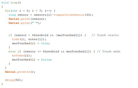

Step 8: Code: Loop
The loop() function runs over and over, forever.
  1. Inside it, we use a for loop to check all 7 sensors.
  2. capacitiveSensor(30) measures capacitance 30 times and then adds them together. The result (sensor) is a number — a small number if you’re not touching it and a large number if you’re touching it.
  3. We then Serial.print(sensor) and a space.That lets us see the sensor’s values in Serial Monitor
If sensor > threshold and we hadn’t previously touched it (!wasTouched[i]), we:
  1. Start playing a note on pin 11 with tone(11, notes[i]).
  2. Set wasTouched[i] to true.
If sensor <= threshold and we previously were touching it (wasTouched[i] == true), we:
  1. Stop the note with noTone(11).
  2. Set wasTouched[i] back to false.
Serial.println() moves Serial Monitor output to a new line after we finished all 7 sensors.
  1. delay(50) waits 50 milliseconds before starting again.This lets the sensor stabilize and avoids crazy-fast looping.
