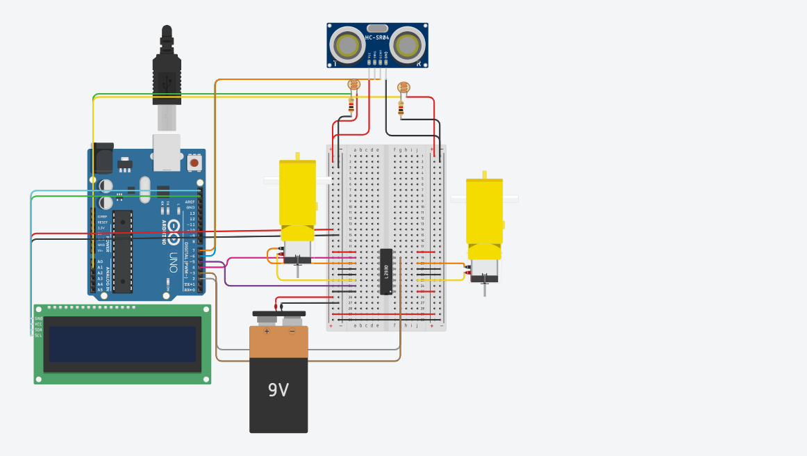

Step 1: Connecting NeoPixel With Arduino
Firstly we will see how to connect the components:
  1. NeoPixel strip 8 has total 3 connections
  • 1st is input connection - Connect it with PWM pin of Arduino
  • 2nd is power connection - connect it with Arduino's +5V
  • 3rd is ground connection - connect it with Arduino's Ground
Note: why use PWM (Pulse Width Modulation) pin ??
-> Digital pins will only give 1 or 0 (LED ON or OFF for Particular color only) but we need more colors which can be only be done using RGB leds.
Here we've used 6 NeoPixel strip:
Connection is as follows:
Strip 1 NeoPixel input pin - Pin 3 of Arduino
Strip 2 NeoPixel input pin - Pin 5 of Arduino
Strip 3 NeoPixel input pin - Pin 6 of Arduino
Strip 4 NeoPixel input pin - Pin 9 of Arduino
Strip 5 NeoPixel input pin - Pin 10 of Arduino
Strip 6 NeoPixel input pin - Pin 11 of Arduino
(NOTE: All this strips are arranged vertically)
You will find the connection idea in attached picture!
Now note that here we've also used simple Led's and created a alphabetical shape - character "Welcome"
As we know Led has 2 legs. 1 leg for ground and other is power.
We've used about 43 Led's its not possible to connect with individual pin of Arduino.
So, we've connected all 43 pins and by using only 1 pin we can Blink all the 43 Led's.
Arrange the Led's in Welcome shape and the shorter legs of all Led's are connected together and attached to Ground pin of Arduino.
Now all the longer legs are connected together but using 1 Ohm resistor, attach that with any digital pin of Arduino.
There is an idea about connecting leds in attached image for reference.
