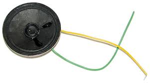

Speaker

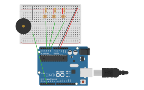

Step 2: Schematic

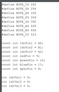

Step 3: Variables
Here I am assigning variable names. The #define variable lets me write NOTE_C4 instead of 262 which corresponds to the frequency played by the speaker. I named the LDR pins and RGB LED pins so i can keep track of whats what. I also created three variables which will store the reading from each LDR

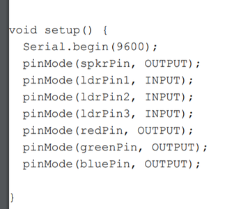

Step 4: Void Setup() {
Here is where I activate everything I will be using. The speaker Pin and The RGB LED pins are set as OUTPUTS. The LDR pins are set as INPUTS. I also activated the Serial monitor to help with values and bugs. You need to find out what values the LDR reads while covered and uncovered to use in the if statements in the next section of code

Here is the beginning of the loop function which repeats over and over. The first three lines are used to read and store the values from the LDR's. There are two example if statements shown but there are 7 in total. When a finger is over the LDR the values increase. My values went from around 100 with all light, to around 400 with all darkness. This led me to pick 200 as a nice middle point. Each if statement is for a different combination of keys being pressed. If a statement is true the a special note is played and a color is shown.

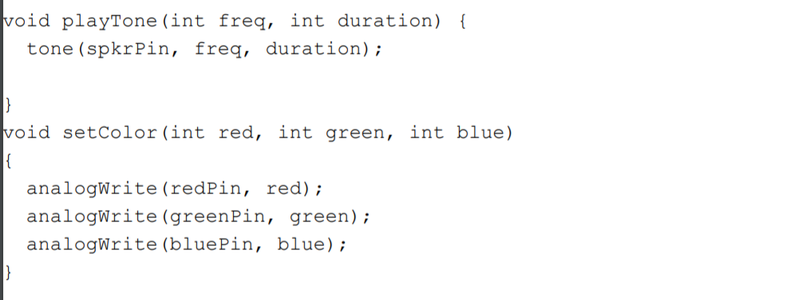

Step 6: Void Other Functions (){
These are two simple function created to make life easier. This shows what is really happening when i can playTone or set color. this saves some lines of code but if you would like you can put what is in each of these functions in the if statements.
