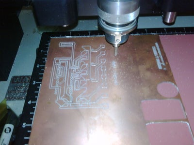

Step 7: Cut the PCB
Use an engraver, CNC, Laser, or etching to make the circuit board.
Special thanks to Steve over at The Award Gallery. Check with your local trophy shop or sign engraver. They may not know they have this ability.
My board was cut on a 10 year old trophy/plaque engraver. I used NOVARM's DipTrace to make my schematic and PCB.

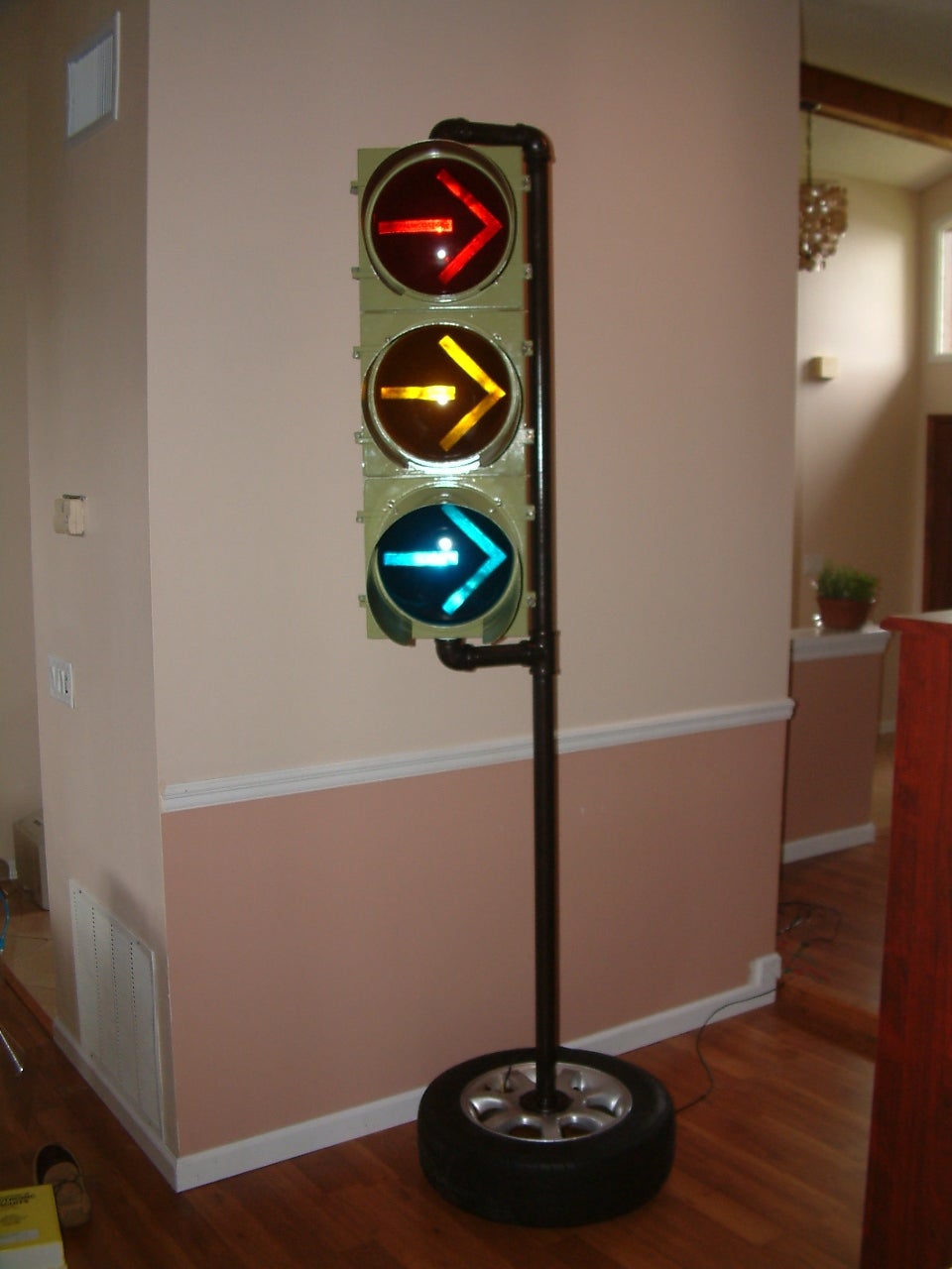

Step 10: Finish
Ada Boy! Sit back and enjoy the fruits of your labor.
BTW the light bulbs are handmade high efficiency LED's. This whole traffic light draws less than 10W at 5V with all three lights on.
