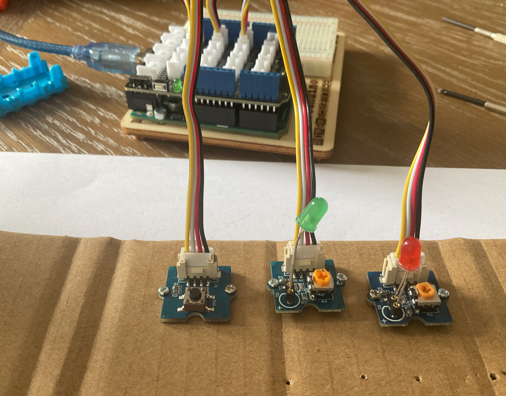

Step 1: Build the Circuit
Follow the following instructions to build the traffic light circuit.

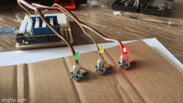

Step 2: Code
The following code will get the traffic lights working.
//Add Libraries
#include "Led.h"
//Global Variables
//Create Objects
Led redLED(2);
Led amberLED(3);
Led greenLED(4);
//Setup
void setup() {
//Main Loop
void loop() {
 greenLED.on();
 amberLED.off();
 redLED.off();
 delay(3000);
 greenLED.off();
 amberLED.on();
 redLED.off();
 delay(1000);
 greenLED.off();
 amberLED.off();
 redLED.on();
 delay(3000);
