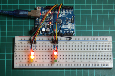

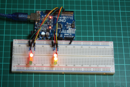

Step 2: Wiring It Up:
Each LED cathode (short lead) is wired through a 220 Ohm resistor to Arduino GND
Left Lights Arduino Pin
- Red 11
- Amber 10
- Green 9
Right Lights
- Red 8
- Amber 7
- Green 6
