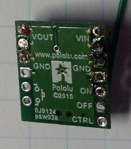

3) Pololu Mini Pushbutton Power Switch with Reverse Voltage Protection (part number 2808). This can be plugged directly into the mega board with header pins but can be remote mounted. This is how the Arduino turns itself off. More on this later. https://www.pololu.com/product/2808/resources

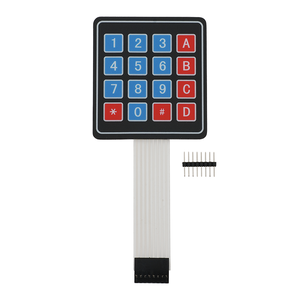

5) a 4x4 keypad with array wiring. This can be made up with 16 switches if you want but for about $4 I got a five pack of them from Ebay.
http://www.ebay.com/itm/5pcs-4-x-4-Matrix-Array-16...

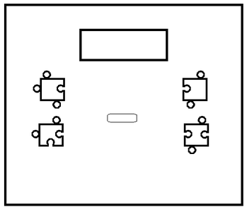

Step 3: Building the Box Face...
I built the face of my box out of birch plywood and used hardwood for the sides simply for the reason that I wanted this thing to be reused several times. The birch plywood I bought from Hughes Hardwoods in Sacramento. The hardwood pieces are carefully scavenged pieces from pallets. I started with this step because the size of the electronics would determine the size of the box. In retrospect I could have made the thing about 1/3 the size but it does have a sense of wow when you come upon it during the hunt.
Start with the face plywood and build everything else around it. Mine is 19"x 14" +/-

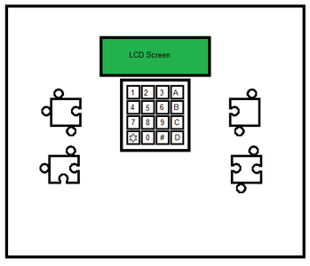

Locate the center of the plywood side to side and then about 1/3 down from the top. As you see in the picture there are three things that need to be in line on the back. From the top is the LCD, then the keypad and on the back is the "magic spot" where a reed switch is located to activate the Pololu switch.
Using a scroll saw I cut a hole for the LCD screen to press fit into. You will be gluing it in from the back but a tight fit makes it look cleaner. I used a router to round over the hole sides.
Figure out where you want your puzzle pieces to be. They don't have to be puzzle pieces. They could be random shapes just so long as each will only fit in its own hole and only one way. I don't recommend a circle, a perfect square, or triangle because those shapes can be inserted in more than one way. This may make the magnets not line up with the reed switches when the key is inserted.
I fired up the scroll saw and randomly cut 4 puzzle pieces out of the face. One of my pieces is shaped so that it can fit in the hole two different ways. (oopps!) I used a bit of paint to identify which way the piece is supposed to be inserted.
Just below the hole for the LCD is a jelly bean shape hole to allow the ribbon cable for the keypad to pass through to the back where all the electronics are. I situated the keypad where I wanted it to be then lifted the edge and marked where the hole needed to be. I made the hole wide so that when the sticky backing of the keypad was stuck to the wood the ribbon wouldn't leave a lump under the keypad. I also had to bevel the edges some to get it to lay flat. Try it out on a scrap piece of wood to see how it will lay and where you want it to be.

After the frame is attached to the box, flip it over and mount the keypad and the LCD screen to the face. I used a little hot glue on the LCD screen to make sure that it wouldn't pop out.
Step 5: About the Pololu Switch...
The Pololu switch has several terminals and not all of them are used here.
Vin and ground is where the battery is connected
Vout and ground are connected to the Vin and ground of the Arduino.
DO NOT CONNECT POWER FROM POLOLU SWITCH TO 5V PORT ON ARDUINO YOU WILL TOAST THE BOARD. The Vin port on the Arduino passes the incoming power through the power regulator so that the board only has 5V. Connect the Vout of the Pololu to the Vin of the Arduino.
The reed switch that is below the keypad on the backside connects +v of the battery to the "on" terminal of the Pololu switch.
Pin 12 on the Arduino is connected to the "off" terminal on the Pololu switch. When the sketch runs a timer and decides it is time to shut off the Arduino it digitalWrites pin 12 HIGH and this turns off the Pololu switch. Once the Arduino powers down pin 12 drops back to zero and the Pololu switch can be reactivated with the magnet.
Wiring diagram to follow in later slides.
(*inside program trick)
I know you're thinking,"If the Arduino shuts off then doesn't it start back from the beginning of its program? How do you get it to remember where it was and not have to view the previous clues every time the ring of power is used?"
Excellent question grasshopper. This is jumping ahead some but here is a taste of the secrets of Arduino Kung Fu.
I use an EEPROM.write to save a number to the onboard EEPROM before shutdown. The EEPROM is a section of memory that is not affected when the power is lost to the board. Every Arduino has one. When the board restarts with the use of the ring of power, The first part of the startup is to read the EEPROM number back in to tell the sketch where it left off. The sketch will skip ahead to that spot. Easy squeezy. More on this when we get to the sketch.

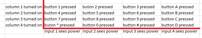

Step 7: The Keypad...

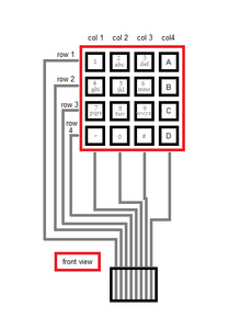

For those who have never used an array type keypad this is how they work.
In an effort to reduce the number of wires that come out of a key pad, conductors are laid out in rows and columns. This type of keypad takes some Kung Fu to make them work but it also reduces the number of pins that you need to use.
In a standard wired key pad you have one common wire and one wire for each button. In this case that would be a total of 17 wires.
In an array wired keypad you have only 8. Here's the catch. The micro controllers has 4 pins set as outputs (the rows) and 4 pins set as inputs (the columns) You can only read 4 buttons at a time.
"What???!!! What good is that to me I bought a 12 button keypad!"
Only one of the row is turned on at a time. For example the first row is turned on, this puts power to one side of each button on the top row (1,2,3,A) If 1 is pressed then you know power is flowing from output 1 to input 1. If 2 is pressed then you know that power is flowing from output 1 to input 2. If 3 is pressed then power is flowing from output 1 to input 3, and if A is pressed then power is flowing from output 1 to input 4.
If you were to turn output 2 on that would put power to one side of each of the buttons on the second row (4,5,6,B) if 4 is pressed power flows from output 2 to input 1. If 5 is pressed power flows from output 2 to input 2. If 6 is pressed then power flows from output 2 to input 3 and lastly if B is pressed power flows from output 2 to input 4.
How do i read the whole key pad you ask. Another good question grasshopper. Here is how it works. The micro controller thinks very fast, so what happens is this. Row one is turned on which is connected to 1,2,3,A and all four of the inputs are looked at. If no power is found at any one of the inputs then that row is turned off and then row 2 is turned on which is attached to 4,5,6,B. Then all four inputs are looked at again. If no power is noted at the inputs then that row is turned off and row three is turned on which is attached to 7,8,9,C and the inputs are again looked at. If no power is again noted at the inputs then that row off and the fourth row is turned on which is connected to *,0,#,D. and again the inputs are looked at for power. If no power is noted then row 4 is turned off and the processes starts all over again with row one.
*Important part - If you turn on more than one row and a button is pressed then there could be two possibilities as to which button is pressed since there is more than one source power coming from two different rows. Say you turn on row 1 and row 2. If you press the 1 button then power will be seen at input 1. If you press button 4 then input 1 will see power again. Got it?
Here is where it gets cool. The micro controller moves so fast that no matter how fast you push the button the scan will see your finger on a button a bunch of times before you can get your finger off the button. In the program you write an if statement. "If my finger is seen on a button then stop the scan and wait for the button to be released (this keeps you from entering 5000 button presses before you can get the finger up.) Once your finger releases the button then using the row and column chart set a variable to reflect what number was pressed. Then go back to scanning the keypad again waiting for another button press. An if statement has to be written for every combination of row and column.
I can hear some of you saying "There is a library for that already made, its called keypad.h" That is correct, there is, however I didn't want to constantly be scanning for a button press, only at certain times and this way it is somewhat easier for me to control, or at least in my head it is. The scan is written into a separate function from the loop function. At certain times during the loop if I want to look for key presses then I send the program to that function which then runs the scan once. I have written my loop to progress in steps and ignore all the rest. So as the loop comes around the and that step is active then the scan is called for. Mostly easy squeezy.
