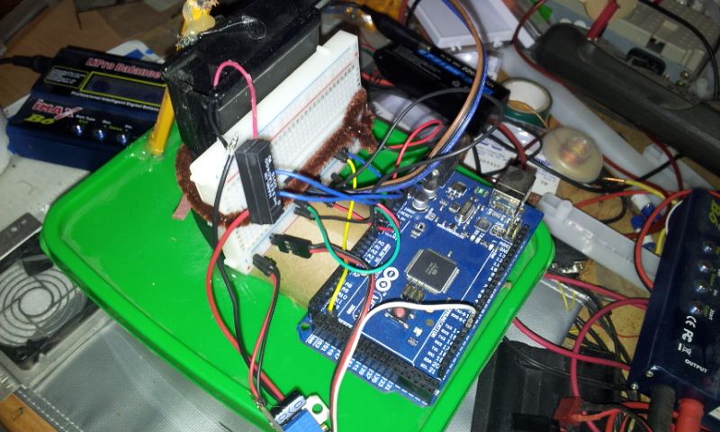

Step 2: Lets Start at the Begining - Arduino
I really wanted to get this Diecimila copy Arduino board bit it took me ~2 weeks to get it by mail so I just had to start fast with my own bread-board Arduino so I purchased an ATMEGA168 and thought I could get it running without any more components .. to my suprize it didn't work and I just had to get another shipment with a 16Mhz crystal and two 22pf caps .. then I got the next ...
Step 3: Bread Board Arduino
I basically took junk apart and added the components one by one ...
most of the information can be found in the Arduino web page :
http://arduino.cc/en/Main/ArduinoBoardDiecimila
They realy have everything you need .
It took me about a week to get it up and running (bootloader / building an ISP cable and an RS232 cable ...) - you can read all about this in the site above .
Step 4: FET With 2.2Ohm Load
it was fairly simple to add a FET with "on" resistance of ~8mOHM (no barly any power disipation on it) and a 2.2 10W resistor .
I connected two A/D pins from the Arduino to the resistor poles and subtracted the values to get the exact volatge drop on the resistor .
Now I samples them every second and acumulated the current (I=DeltaV/R).
I also added a buzzer to indicate when charging was over and stoped the discharge .
