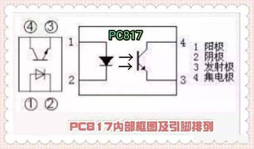

PC817
The optocoupler is extensively utilized in computer terminals, thyristor control devices, measuring instruments, copiers, automatic ticketing systems, and household appliances like fans and heaters for transmitting signals between circuits. It provides complete isolation between the input and the load, enhancing safety, minimizing circuit interference, and simplifying circuit design.

Main Parameters:
  1. Optocoupler
  2. Current Transfer Ratio: 50% (minimum)
  3. High Isolation Voltage: 5000V (rms)
  4. Compliance with UL standards
  5. Limiting Parameters:
  6. Reverse Current (ICEO): 50mA
  7. Peak Forward Current (ICE max): 1A
  8. Reverse Voltage: 6V
  9. Power Consumption: 70mW
  10. Collector-Emitter Voltage: 35V
  11. Emitter-Collector Voltage: 6V
  12. Collector Current: 50mA
  13. Collector Power Dissipation: 150mW
  14. Total Power Dissipation: 200mW
  15. Operating Temperature: -30°C to +100°C
  16. Collector-Emitter Saturation Voltage: 0.1V (typical)
  17. Cutoff Frequency: 80kHz
  18. Current Transfer Ratio: 50%-600%
  19. Package: DIP-4
