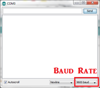

Step 4: Testing
Just upload this code and click on serial monitor, serial Monitor is opens now set the baud rate equal to 9600.
Code is ready you can measure the temperature, if heat is given to sensor using lighter value on serial monitor will increase, this is clearly visible in video.
