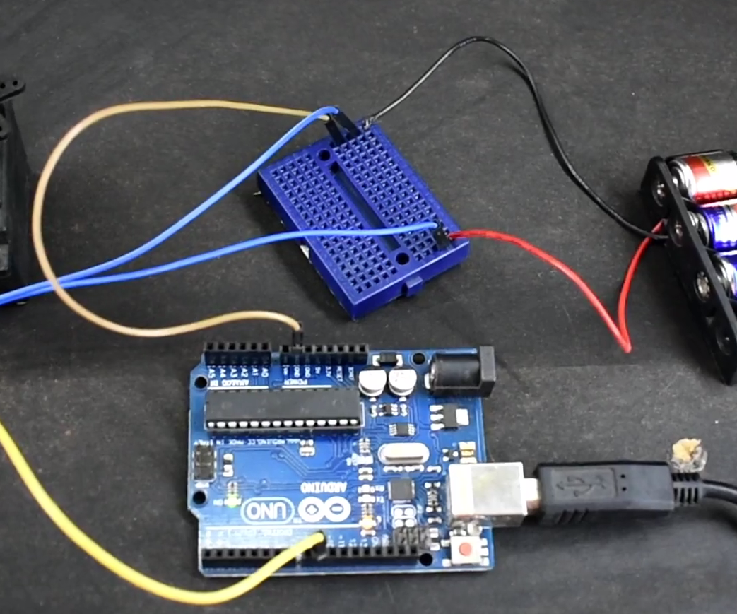

Step 3: Circuit & Connections
connect to
p1 - +Vcc
p2 - GND
p3 - A0 ( analog input )
The Stepper motor used here is a rusty old EPOCH (5 wires) stepper motor, which is a unipolar stepper.
Use the analog input with the help potentiometer to control the delay in-between each steps of the stepper motor. Shorter the delay in-between each steps - faster the stepper motor runs and vice-versa.
