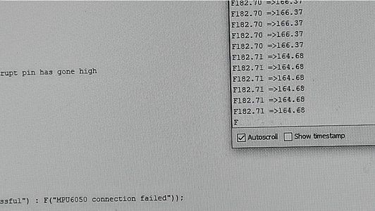

Now comes the fun part, which is customizing the code specifically for our built device. Depending on the layout of the components, the center of gravity of the robot changes, and also each MPU6050 board has minimal differences that need to be compensated for in part of the code. If we look at the code in more detail, we will see that there is a place where the Gyro offset is set.
In this part of the code, errors are corrected during the manufacturing of the MPU6050 chip. For each individual chip, these values are different. Their value is determined using Arduino code made specifically for this purpose and you can download it at the end of this text.
Next, we need to move on to setting the Accelerometer. In the "double setpoint' line, we need to put a value that corresponds to our device.
To obtain this value, we need to hold the robot in an ideal vertical position, perpendicular to the surface, and read the required value on the serial monitor. In my case, it is about 182
Finally, we need to experimentally determine the values of Kp, Kd, and Ki, needed for PID control.
For this purpose we set all three values to zero. Now we put some value for Kp and perform testing. Too little Kp will make robot fall over. Too much Kp will make the robot go back and forth wildly. A good Kp will make the robot go slightly back and forth. Next we need to set Kd. A gooD Kd value will lessen the oscilation until the robot is almost steady, and will keep the robot standing. Lastly set the Ki. The correct Ki value will shorten the time it takes for the robot to stabilize. I want to emphasize that the surface needs to be rough enough to increase the friction between it and the wheels.
