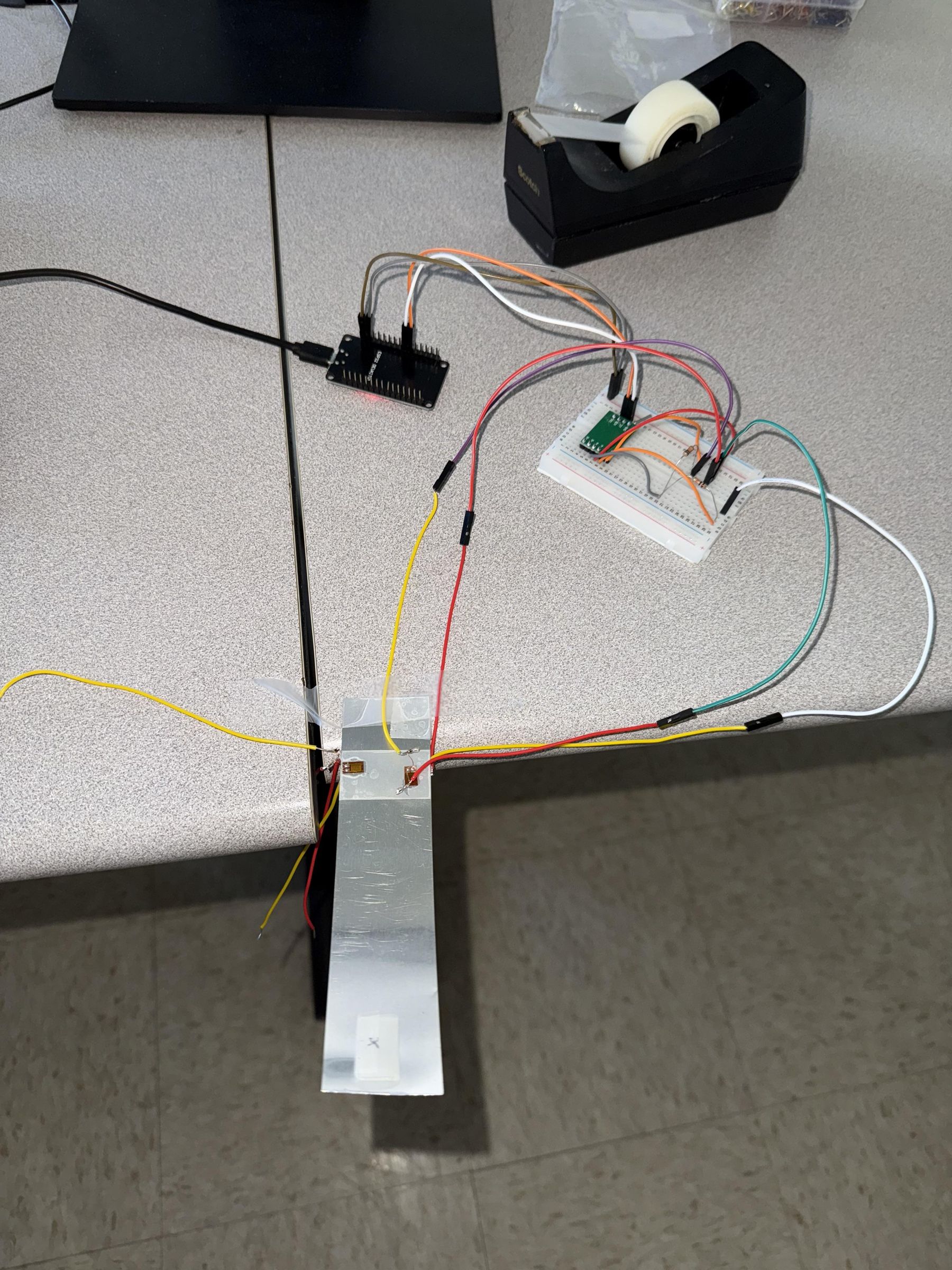

An ESP 32 microcontroller circuit was setup to read a type K thermocouple with a digital thermometer reference input.
1 Breadboard
1 Type K Thermocouple
1 HS711 Amplifier
1 ESP 32
1 DS18B20 Digital Thermometer
3 Resistors (any resistance)
Assorted Jumper Wires
1 USB to ESP 32 Connector

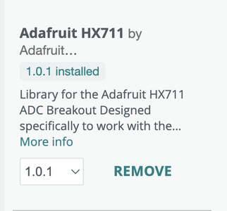

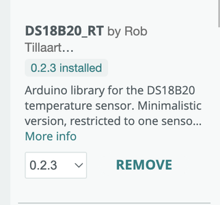

-Open Libraries folder and download Adafruit_HX711 library as well as the DS18B20 Library by Rob Tillaart
Step 2: Test Digital Thermometer
-Wire breadboard according to image shown above. IMPORTANT- make sure polarity is not reversed on DS18B20 or thermometer will overheat
-Open "One Wire" example from One Wire library (select temperature example)
-Change Pin on line 10 to match desired serial pin on ESP 32
-Click upload and confirm on serial monitor that a reasonable reading is being given
Step 3: Thermocouple Integration
-Wire breadboard according to images above
-Download attached code titled MAE_411_001_code
-Change baud rate to match your microcontroller (typically 9600)
-Change lines 5,6 to match your respective data and clock pin inputs
-Upload to board and monitor output using serial monitor
-Verify accuracy with a known temperature source such as an ice pack or controllable heat source
*Note lines 108-125 are performing thermocouple voltage to temperature calculations (in units of celsius). Do not change these unless you wish for different units or a more accurate alpha value (linearity value)*
