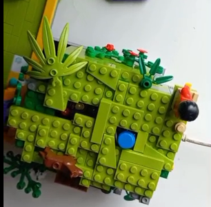

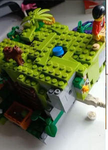

Step 5: Building the Arduino Housing
The first step is to place the 2 LEGO 16x6 plates (3027) next to eachother, and attach them using the 2x4, 3x2 and 2x1 bricks in various shades of grey. Place your Arduino Uno in the middle of these plates and secure is with the bricks, leaving space for the wires, USB connector and power port.
Place a couple of 8x1 bricks above the Arduino to place the breadboard on.
keep building upwards with lime bricks and keep a 4x2 hole for the servo motor.
Finally, conceal most of the breadboard with flat lime LEGO plates, leaving only the button and LEDS exposed.
For decorating you could use LEGO 1x1's with a stud on side (87087) to place LEGO 6x5 Plant leaves on, and put plants, the ladder and crate on the build.

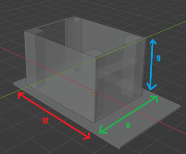

Step 7: Wooden Housing Design
Here are some instructions if you want to make a wooden housing instead of working with LEGO.
first I make a design, which uses 2 9x9 cm boards for the front and back, and 3 9x12 boards for the sides and top. to fasten everything together, use 4 small slats in the corners.This housing is larger than the LEGO version, but the Arduino fits perfectly.

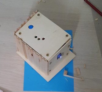

Step 10: Making It Arduino-proof
now it's time to mark where your arduino cable will go, and unscrew the back of your base.
With a jigsaw you can cut the hole and screw the back back onto your base. You repeat the same process for the front, where you servo sticks out of.
Then its time to screw your arduino to the baseplate. You do this by marking the holes onto your plate with a pen, drilling tiny holes and then screwing the screws in using tweezers.
Now you will create the support for your breadboard. You do this by taking a smaller beam and mounting it between the two rear beams. Then you can screw your breadboard to this bar.
For the top of the housing I first made a cardboard prototype. After cutting holes in it and making some iterations I was able to draw the position on the wood.
First you drill holes where you want them, and then put your fretsaw through the hole and close the fretsaw.
After putting everything back together your base is finished!
