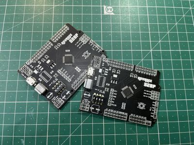

A better compatible and fully featured Arduino Development board. Now comes with extra headers and better component orientation.
Step 1: Story
A new version of Arduino UNO PRO is out now, I changed the orientation of components and a specific improved design. Now has more compatibility options with micro-USB port for power delivery and programming. This Arduino UNO pro version has all the similar features to the previous one, you can see version 1 from here. But there are some issues in the I2C screen positions and sensor headers. If we try to connect the onboard I2C OLED then there is no space to connect the sensor on 3x3 header matrix made by me to overcome the problems of external jumpers.

I only upgraded the ports option, and headers positions are changed. Because I feel a difficulty when placing both sensor and OLED together. For the bootloader and sketch uploading all the instructions are same.
Step 4: Assembly Process:
I used JLCPCB assembly service to get the soldering and parts assembly. The assembly will take only 3 days after manufacturing the PCB and you will get the original components directly from the manufacturers. The quality of soldering and assembling is really fantastic every soldering joint gives the feeling of original Arduino.

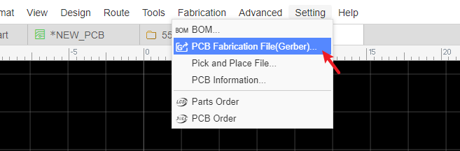

Then convert the designed PCB into Gerber then export BOM and CPL files.
