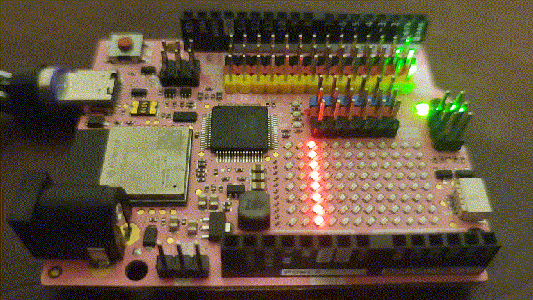

Introduction: Arduino UNO R4 WiFi Experiments
With this project, I hope to demonstrate my Arduino UNO R4 WiFi experiments with the microcontroller board's LED matrix, starting from simply turning on/off each one of the LEDs, to having a simple remote UI for controlling the LEDs of the matrix, using an Android app -- DumbDisplay -- connected using the microcontroller board's WiFi support.

which is basically directly copied from the web page -- Using the Arduino UNO R4 WiFi LED Matrix
Notes:
- The basic initialization for using the LED matrix is like
matrix.begin();
- To manipulate the LEDs of the matrix, a "frame" of 3 uint32_ts is needed, as in happy and heart
- You load and display a "frame" like
matrix.loadFrame(happy);
Since each one of the 96 bits of the 3 u_int32_ts corresponds to a LED of the 12x8 LED matrix, apparently, the LED on/off can be controlled by turning the proper bit on/off, with routine like the following set_bit() which sets the corresponding bits of frame on/off

Accordingly, let's try to turn on/off each of the LEDs one by one with sketch src/INO/matrix_obo_test/matrix_obo_test.ino

Once connected, you should see the virtual joystick displayed.
Moving the joystick should move the turned on LED of your Arduino UNO R4 WiFi LED matrix.
