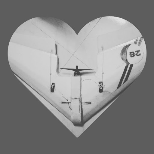

Step 6: Flight
Wow, this is the final product, she so beautiful and very compramising
