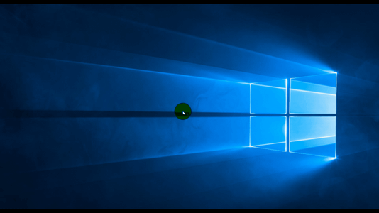

Step 4: Setup Shortcuts
You can create up to four shortcuts. In the video above I show how to create the shortcuts and assign them a shortcut key.
Right-click on your desktop then go down to "shortcut". Then create your shortcut. Click on next. Now name your shortcut. Once it is named left click on the shortcut and go down to properties. Then assign the shortcut key to like to it.
