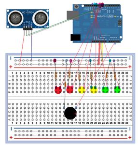

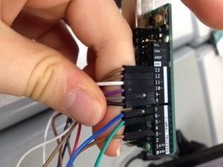

Step 2: Step 2: Connections
Connect all of the components to look the same as the image above.
Ports 13-8 are the LEDs
Ports 7,6 is the Ultrasonic Sensor
Port 3 is the buzzer
