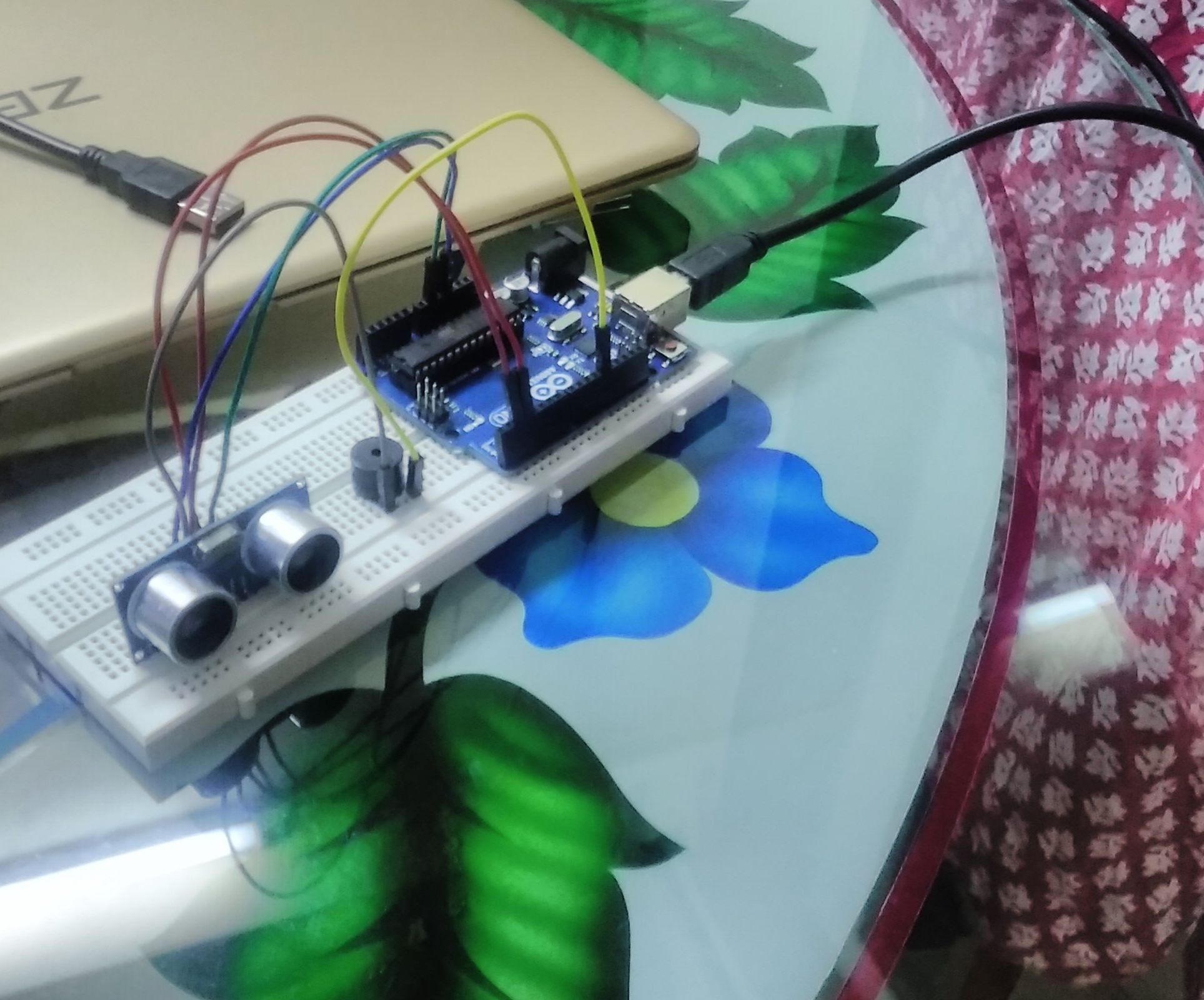

This is a simple Arduino ultrasonic sensor hcsro4 door alarm.
This mechanism is very simple and easy.
You can do it with only some of the parts in the Arduino Uno set which I have bought from Amazon.
These are the parts we are gonna use in this set of the project: :
1 : HC-SRO4
1 : simple buzzer
1: simple and small breadboard
1 : a - b usb cable
6 : jumper wires
1 : generic Arduino Uno board
Softwares ;
Arduino IDE
1 : HC-SRO4
1 : simple buzzer
1 : a - b usb cable
6 : jumper wires
Softwares ;
Arduino IDE
Step 1: Connections
Vcc- 5v
Trig Arduino pin 2
Echo Arduino pin 3
Gnd to gnd
Trig Arduino pin 2
Echo Arduino pin 3
Gnd to gnd
