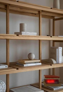

Introduction: Arduino Ultrasonic Sensor HC-sr04 Led + Bookshelf Light Project
A bookshelf light that lights up when an object or your hand is close to the sensor. The design is minimal and rectangular so it doesn't get too much attention and can fit in like a book.
