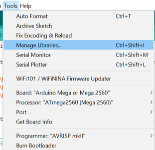

Step 5: Getting the Library for TFT Display in Arduino IDE
Library Requirement:
Adafruit_GFX.hMCUFRIEND_kbv.h
Step:
  1. Go to Library Manager from the tools menu
  2. Search for Adafruit_GFX and install it
  3. Search fo MCUFRIEND_kbv and install it
  4. Library resources documentation datasheet

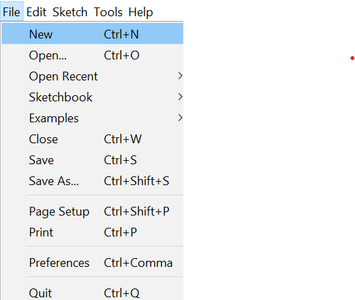

Step 6: Upload the Arduino Sketch Part A
Part A Creating A New Sketch File:
Firstly Create New File on the Arduino IDE and Copy the Following Codes or go to my GitHub:
// By BobWithTech at Instructables.com// All Involved Library setup are included from the library below:#include "Variable_Setup.h" //All function and library in there just to make it neatvoid setup() {  //Initialise the Serial Monitor for Debugging Purpose or etc  Serial.begin(9600);  //Pin Mode Setup  pinMode(buzzerPin, OUTPUT);  pinMode(bPin, OUTPUT), pinMode(gPin, OUTPUT), pinMode(rPin, OUTPUT);  pinMode(trigPin, OUTPUT), pinMode(echoPin, INPUT);  uint16_t ID = tft.readID();  if (ID == 0xD3D3) ID = 0x9481; //force ID if write-only display  tft.begin(ID);  tft.setRotation(5); //Set Directinal Rotation Display Of The Intended Display    Serial.println(tft.width()); //print the maximum width dimension  Serial.println(tft.height()); //print the maximum height dimension    //Preparing the background display and clearing the previous display  startupDisplay(); //setting up the display}void loop() {  // put your main code here, to run repeatedly:  final_result();  delay(70);}
Step 7: Upload Arduino Sketch Part B
Part B Creating A New Library File:
Secondly press Ctrl+Shift+N to create a new tab on the Arduino IDE and name it "Variable_Setup.h"
then Copy the Following Codes in that tab with:
