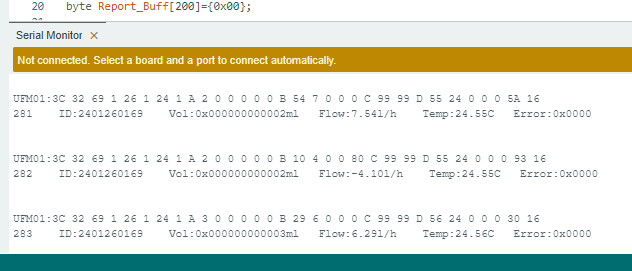

The program we worked on in house had some trouble parsing the hex output of the UFM01 sensor. The sensor’s output is a hex string of human readable decimal number pairs, least significant first. Thus, an output of “29 06” translates into 6.29 liters/hour of flow.
A request for tech support help from ScioSense was made, and after some trial and error (note the indicated temperature on the OLED), code was written that properly parses the output of the UFM01 to the Arduino, and displays it on the serial monitor. See Picture.
From the illustration, you can see the ID (serial number), Volume, Flow and Temp. From the data sheet, the number 80 before the C indicates a negative value. This is handled in the code.
