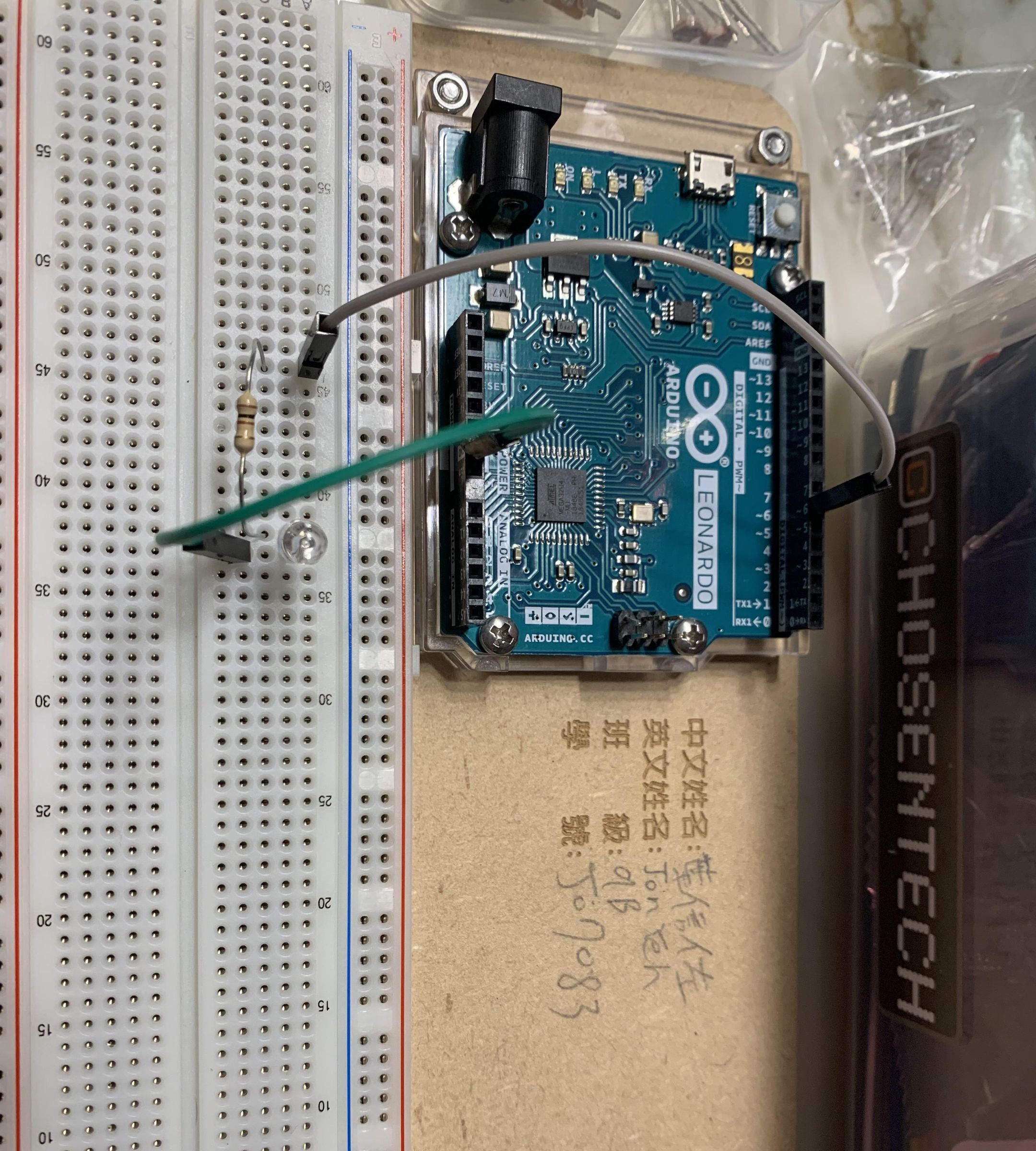

Step 2: Hardware
In all of the materials, I will build the Fischer building blocks into a car and connect the structure with the two Arduino boards to get the message from the code, which gives the instructions to the jaw and the ultrasonic sensor so the jaw is able to catch the things' directions and working in the system of the program that I wrote.

Step 4: The Circuit Sketch
