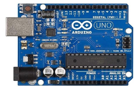

  1. Arduino Uno board

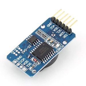

  2. DS3231 RTC board

Note: We used 3.3 V power supply for RTC board. It is recommended to check whether the RTC board being used is 5V compatible or not.
