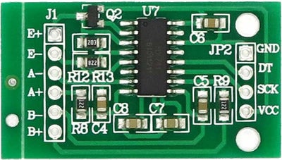

IMPORTANT NOTE: Make sure all solder joints are completely and solidly soldered on the HX711. It is very sensitive to external EMF. One of my connections was off just a little and the numbers went HAYWIRE! I would wave my hand 3 foot above the rig and it would stop dead in it's tracks.CRAZY MANNNN....CRAZY!!!

HX711 E+-----------------------LOAD CELLRED
HX711 E- -----------------------LOAD CELLBLACK
HX711 A- -----------------------LOAD CELLGREEN
HX711 A+-----------------------LOAD CELLWHITE
DO NOT CONNECT B+ B-
