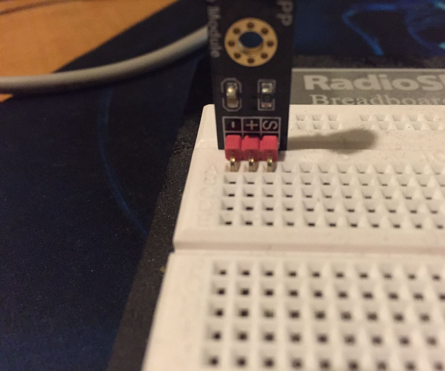

Step 2: PIR Sensor
After we take our sensor out of the package, we can see that it is fairly simple:
- Has the main sensor on the board
- 3 pins: Ground, Voltage In, Signal

First, I attach power from the Arduino Uno to the Bread Board
Next, I attach the sensor to the Bread Board and Jumper Positive and Negative power to it
Lastly, I jumper the Signal terminal to the Arduino Uno (I used Digital 2)
