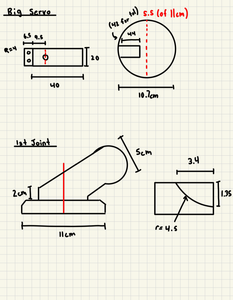

The idea behind this project was that I was inspired by robotic arms that are used in factories for manufacturing. I wanted to attempt this project to explore this interest in robotics and also learn more about electronics and 3d modeling. The first part of this project is creating the various parts of the arm. For this phase of the project since I wanted to create all the parts by scratch I started off with a design phase. During this phase I took all the measurements of my components being the servos and connectors for the wires. Below are some design drawings I did to come up with the final design. This process is very useful to map out what design aspects I wanted to keep and which ones I didn't want to include.

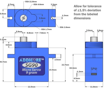

The first part of this project is designing the base. This is the foundation of the arm and stabilizes the whole arm. For this piece I made sure to design the middle of the servo piece to line up directly in the center of the piece. When designing this piece something that had to be mindful was on the servos the center of the rotating gear is off centered. So make sure to keep this in mind if you want to design your own parts. Below I have added some photos of each of the servos that were useful for the designing process.
