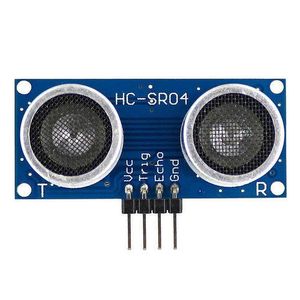

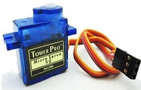

All you need for this Arduino Project is an Ultrasonic Sensor for detecting the objects, a small hobbyist Servo Motor for rotating the sensor and an Arduino Board for controlling them.

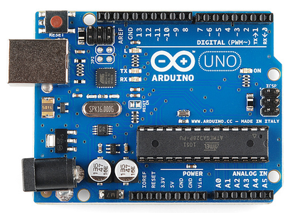

1. Arduino Uno - https://amzn.to/3b3gUZ7
2. Servo Motor & Ultrasonic Sensor - https://amzn.to/3qwIkwQ

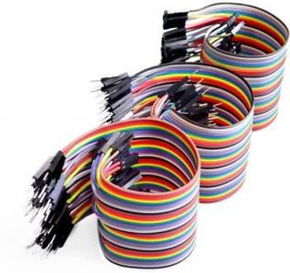

3. Jumper Wires - https://amzn.to/3phYj0E

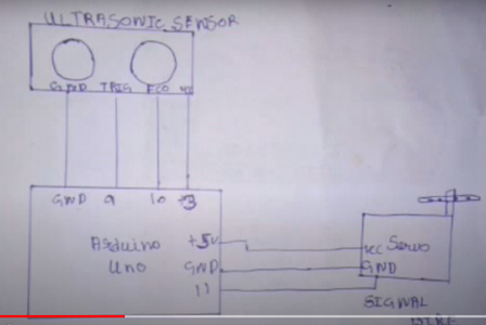

Step 2: Circuit Diagram
