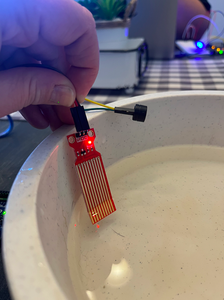

Step 1: Connect Water Level Detector
Using 3 of the Female-to-Male Dupont Wires, connect the Water Level Detector. The negative leg (-) goes to the ground on the Arduino Uno. The positive leg (+) goes to the 5V power on the Arduino Uno. The Analog Signal (S) goes to the analog in on the Arduino Uno, specifically in port A0.

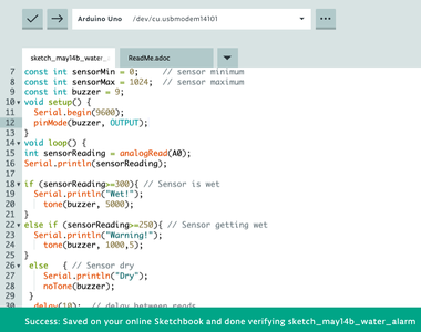

Load the sketch (below in multiple formats) into Arduino Create and connect the Arduino Uno.
Link:https://create.arduino.cc/editor/jodi_clark/6687257a-940b-4726-baff-d8230c00e40a/preview
Copy & Paste:

const int sensorMin = 0;   // sensor minimum
const int sensorMax = 1024; // sensor maximum
const int buzzer = 9;
void setup() {
 Serial.begin(9600);
 pinMode(buzzer, OUTPUT);
void loop() {
int sensorReading = analogRead(A0);
Serial.println(sensorReading);
if (sensorReading>=300){ // Sensor is wet
 Serial.println("Wet!");
  tone(buzzer, 5000);
else if (sensorReading>=250){ // Sensor getting wet
 Serial.println("Warning!");
  tone(buzzer, 1000,5);
 else  { // Sensor dry
  Serial.println("Dry");
  noTone(buzzer);
 delay(10); // delay between reads
Step 4: Test Run
The final step is to use water for a test run. Put the water sensor into the water and hear the alarm sound depending on how deep it is in your test water. If you would like the alarm to sound with either higher or lower water levels, you can adjust accordingly with the code (sensorReading>=300 & sensorReading>=250). Once you are satisfied with your water levels, place in your basement so it can alert you if the water starts a floodin'!
