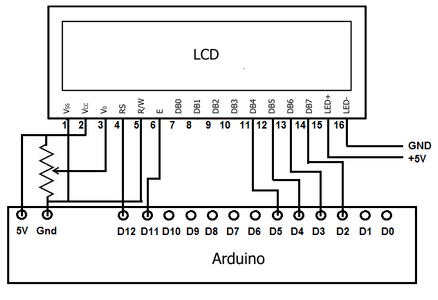

Step 2: Assembling the Circuit
Step - 1
Gather the components needed for assembling the circuit.
Step - 2
Hook up the LCD Screen to the breadboard
Step -3
Hook up the wires to the breadboard from the arduino so that the board can recieve power
Step - 4
hook up the wires to the LCD screen now
1 VSS 0V Ground
2 VDD 5V Supply Voltage
3 VO (Variable) Operating voltage
4 RS H/L H: DATA, L: Instruction code
5 R/W H/L H: Read(MPU?Module) L: Write(MPU?Module)
6 EH H->L Chip enable signal
7 DB0 H/L Data bus line
8 DB1 H/L Data bus line
9 DB2 H/L Data bus line
10 DB3 H/L Data bus line
11 DB4 H/L Data bus line
12 DB5 H/L Data bus line
13 DB6 H/L Data bus line
14 DB7 H/L Data bus line
15 A 5V LED +
16 K 0V LED-
